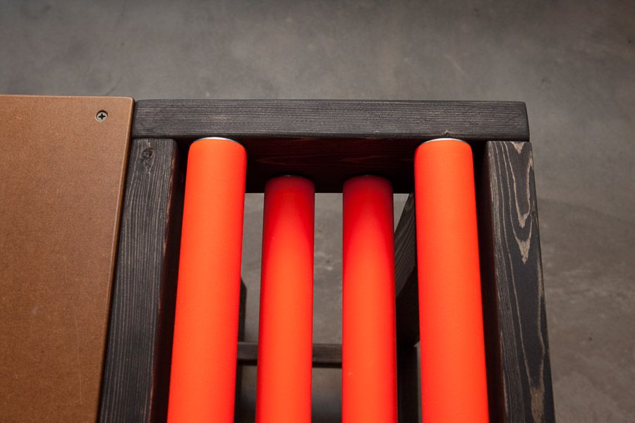

I haven't seen a table like this before so I thought some of you might appreciate it. It doesn't have any fancy automation, or lasers, but it's a big improvement over my previous cutting table. The 6'x8' cutting surface, and roller cradle definitely speed up the cutting process. I lay the roll of fabric in the "cradle" then pull out however much I need. The rollers keep the bolt in place and let it unroll smoothly. Then when I'm done, the rollers allow me to roll the bolt back up quickly, and straight. The table is constructed with 2x4s, 2x6s, 4x4s, and MDF, screwed together with Deck Mates. The bottom shelf is used to store rolls of fabric

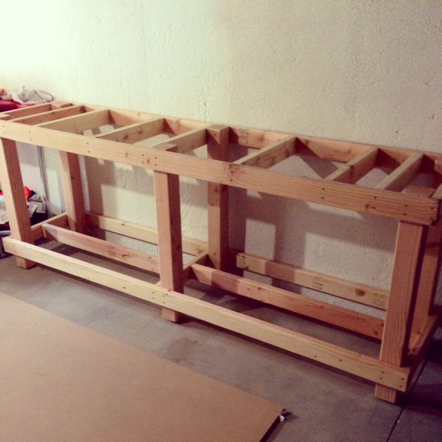

I don't have any construction shots of the cutting table, but it's made basically the same as my packing/shipping table:

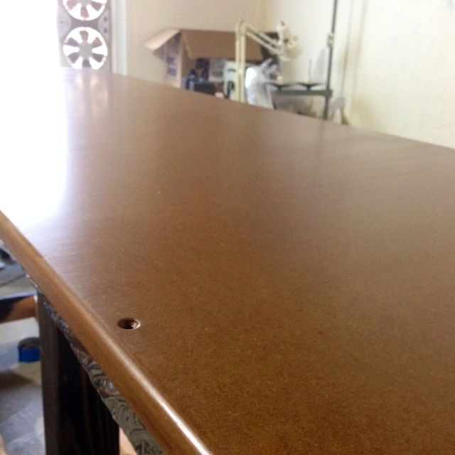

MDF looks surprisingly good after several coats of polyurethane:

Nice table, looks really solid! I assume you use a cutting mat between the table and the fabric? What's the tabletop height?
Yeah, when using a rotary cutter I use a cutting mat: either a 47.5"x35.5" Concept, or 37"x25" Dritz. The table height is 37.5"
