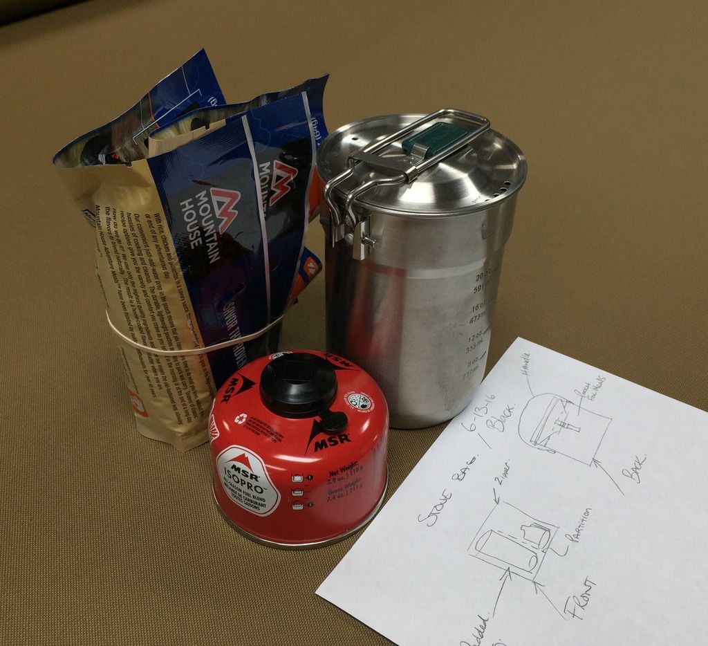

Hey guys, I wanted to share a project that I committed to for a friend of mine. He asked me to design a go bag for his stove and food.
I have some notes of the things that he wanted which include a partition inside the main bag and a zippered top. He also wanted a pocket on the back which will hold his bags of food.
Since he isn't in a hurry for this and I really don't have a solid plan, I wanted to do this in a blog style so everyone can see as this project comes to life.
My first thought is to design it like a binocular bag with an added pocket on the back. I plan on using Ballistic nylon on the outside and brown Pack cloth inside. (On second thought, maybe tan 498 500d). I prefer to use a lighter color than black inside so things are easier to see.
Enjoy, Scott

Does his intended use include operating in areas where there are bears? It's common to hang your food bag as a means of protecting your food (check out the PCT Hang or Counter-Balance methods) so you might want to include a loop for attaching your line to. A small pocket for your bear bag line and carabineer might be nice too.

Hey, just an update I finally got around to getting this built, my buddy originally wanted a zipper top but I didn't have a design for that so I just made a standard lid.

With this design I would recommend additional Velcro on the sides of the lid, and to use two 1-inch side release buckle (sewn in non-adjustable way) instead of one wide buckle
