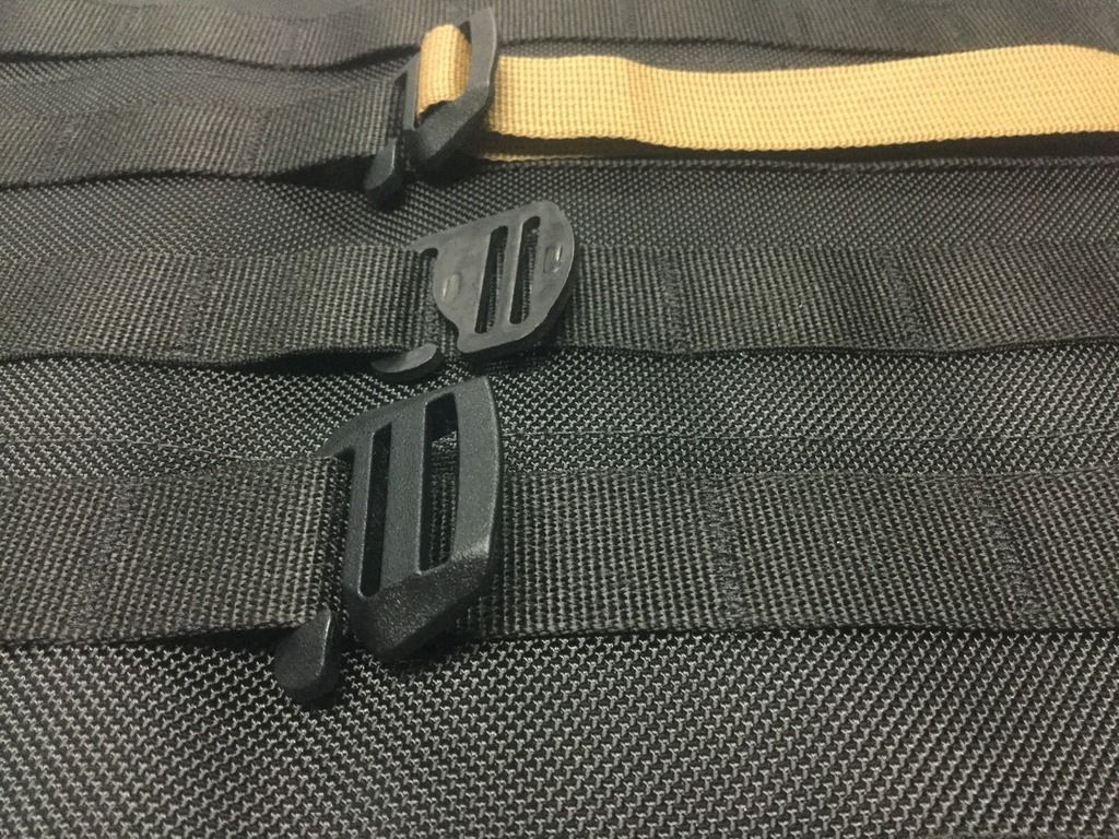

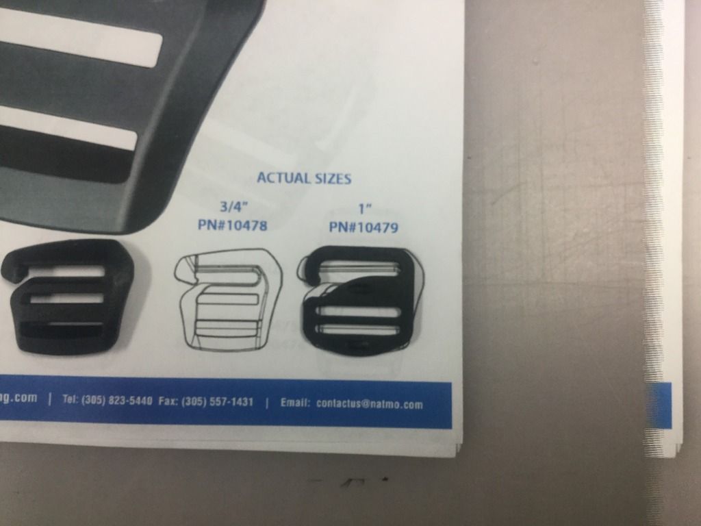

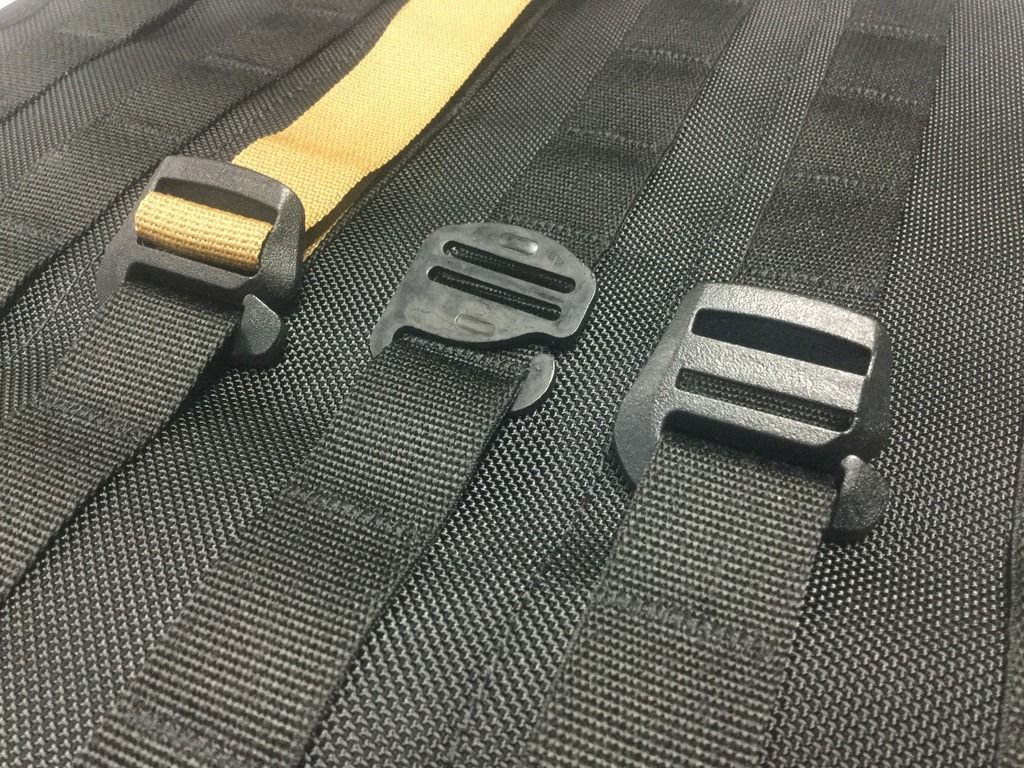

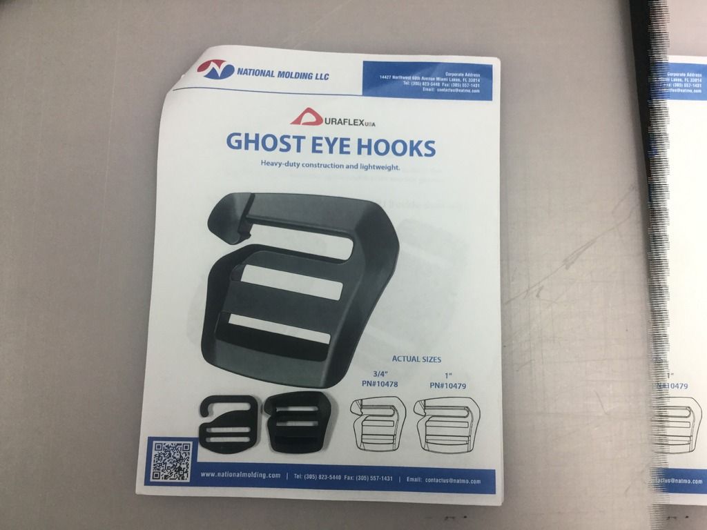

Sorry for the delay, Rita from PK supply in Washington state got me some samples last Saturday, but I have been Jammed up all week getting orders out the door.
My initial thoughts are that the hooks look pretty good, the downside is that if you pull hard on the webbing laced through the hook it flexes open, it never broke and didn't let the webbing fall out of the hook but it may not be considered strong enough to replace a steel hook, I would have to break one while hooked to a scale to really know, but our customers may not like the amount of flex that they see. The next issue is that is thicker than the steel hook so it doesn't lay down as nice on Molle panels. The end of the hook is shaped in such a way to not slip off of the webbing easily but it also makes it tougher to lace it, so it is not a "quick attach" hook.
Keep in mind that these are my "opinions" and should not deter you from trying these for yourself.
In the pictures I compare it to the G hooks that I get from GSI, which are their house brand.
Thanks, Scott

« Reply #7 on: August 20, 2016, 01:32:28 PM »
I've been using the GSI hooks for a longtime, the resistance and coating are good to go in Black, the Tan ones tend to scratch too easily though.
